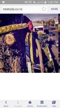

So I'm fairly new in aerial friction. At this point the only devices I have besides packing a porta wrap up the tree is a self made rig-n-wrench (works great and I will be buying the real deal) and a rigsaver from treestuff that has a ring on one end of it. My only concern with purchasing the safebloc is, what's the chance of rope on rope when lowering wood? I've found an image online that shows what I'm thinking may be an issue. Anybody notice any problems from this?

I've thought on that as well. The only way I can see it becoming an issue is if everything would push directly to the spar. In that pic the only thing I can see is added friction and heat. Since both lines are moving I don't see a risk of the line severing.
In that picture it looks like the rope was threaded backward through the bloc. Just make sure to start the rope from the hole closest to the splice and I don't see how it could load that way. I love the SafeBloc... but can say that I watch the rope run through it. I'll maybe have to watch it on Monday.
John, I was just about ready to say the same thing. The rope should have been threaded from spar to the bottom, this keeps the rope from rubbing upon itself. The way it's run in the picture is guaranteed to cause rope on rope wear! If you start from the top lifted toward the spar, feed the rope inward through the top hole, outward through the 2nd hole and inward through the 3rd, if necessary. I hope this helps, be safe and let 'er run!
Anyone with a safebloc mind posting a picture of it ran correctly? Maybe before and after a negative block is cut.
In my mind I'm seeing the rope being either close or in contact with itself even if threaded the way that you are saying.
But I haven't ever had one in my hands to know for sure. Just speculating from pics online.
I'm not seeing it either. No matter what the middle hole brings it back to the part of the line that is going up. It's probably a minute amount of rope on rope wear.
Ya it sure seems like it would rub regardless,if that is the case,I'm going to have to say the picture has it threaded the better way imo
I think it all depends on your rope angles. If you are standing directly under your load when you are lowering it then I could see it happening. If your porty is outside the danger zone then I think the chances are less.
