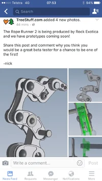

yup. but, Rock has licensed the Akimbo from me and will be making and selling it as a Rock Exotica product. as i understand it, treestuff has hired rock to help design and manufacture the RR2, but it is still a treestuff product and owned/licensed by them. i am personally excited to try it out. there is never going to be a device that 100% of climbers will love. more options is good for everyone in my opinion.
