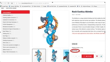

Got an email today from Bailey's online, showing the Akimbo in stock.
