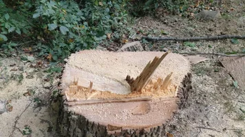

@rico
Look at the fibers on the locust hinge.... Those long whiskers sticking up on the fat side of the hinge clearly showed that the hinge held all the way until the face closed.. You pride yourself on reading a stump, then say that was a gawd awful cut... Why do you think I took the picture.. BECAUSE THE CUT WORKED!!!
Look at the whiskers on the ash hinge... again the hinge clearly held until the face closed... what makes it gawd awful? can you read the stump? that hinge I remember specifically because it held a ton of head and side lean. really surprised me... as I said I was expecting to lose it, so cutting it high (about 6') enough to shorten the fall enough so that if it did hit the fence, it would only be small tips, so that the branch tips would break before the damaging the fence...
Again I took the picture because the cut worked.. If you know how to read a stump you cannot say otherwise.. If you continue to disparage those cuts as you have done throughout this thread, you are truly a dumb ass that has no business commenting on my work.
Both those cuts worked and yet you have repeatedly called them fucked up, gawd awful and referred to me as a hack for cutting and showing them...
Well if you want to call me a hack, you got to call Dent a hack too... Because both those cuts are right out of his book... Did you go read pro timber falling pages 110-111?????
Oh that's right.. Dent's your hero, but you know better than he does.. We should listen to you not Doug Dent... Because your experience has shown you that the tapered hinge, which he calls an "extremely important part of the faller's technique" (pg 99) you refer to as "having "a minimal effect on changing the coarse of a falling tree" and "that most here don’t need to rely on to get their job done". So who should we listen to you or Doug Dent? It's one or the other... there is no gray area here..
And regarding the ash and locust hinges, they are again straight out of Dent's book.. He calls them a swing dutchman. (pgs 110-111) I honestly hadn't touched the book for close to 15 years, so that's one good thing that has come out of all this ugliness.. And I didn't remember Dent's example, or the name of that cut that he calls the swing dutchman, which he refers to as "an effective method of handling the heavy head and heavy side leaner". I basically read it, forgot it, and then some time later discovered it through trial and error. And that is a perfect description of the ash hinge here... It was a heavy front and heavy side leaner. And surprise.... it worked so well...
So once again who should we listen to ... you who call it gawd awful, fucked up hackery, or Dent who calls it an effective method? Dent goes on to say that "many variations occur in the amount of holding wood and the position of the bar..the holding wood on the lean side (you call it downhill) should be severed PRIOR to the final back cut step....the secret of the Swing Dutchman is in determining how much of the remaining holding wood should be cut."
So everyone here can make up their own minds, should we listen to you or Doug Dent? Me.. I'll stick with Dent.. Kenny aka useless info (formerly the tree spyder) is on board with Dent too... But don't feel bad.. You're not alone...

tapered hinge ash.webptapered hinge small locst.webpdent's swing dutchman.webp
I can't keep all your posted pics of butchery straight, so bear with me because I'm gonna guess which ones you are talking about here.
You can change the name from a tapered hinge, to a swinging dutchy, or whatever else you think offers you a little cover, but what I see is a horrendous, unfinished undercut, which may or may not have a little bypass. You then followed up with what looks to be a multi-leveled attempt at a backcut ( look closely and you will see what looks like another shelf that the glove finger is hiding behind). If that wasn't enough you proceed to destroying your hinge with what looks to be a dull butter knife. Were just gonna have to trust you when you tell us it all worked out for the best. Some world-class cutting for sure. Would Doug approve? Who fucking knows, or cares!
Next up is this lovely offering. You tell a tale of starting on the right side, "gutting your Hinge", then finishing it off from the left till it "popped.' What is very obvious is that despite all that "out of the box", super awesome saw work, that fucker went right where it was leaning and sighted (right on the fucking swingset). Kinda proves my point buddy, and I am still utterly mystified why anyone in their right mind would post up a picture showing destroyed property. You should be ashamed of yourself for charging those folks $1000 for such lazy hackery.
Next in the queue is a little something you refer to as the "irregular hinge" with yet a little more "gutted hinge"? We won't talk about the ugly, lazy, unfinished undercut, which once again my or may not be considered bypass.
"Haha.. call me lazy, but it worked." Your words, not mine,. This kind of says all we need to know about your low-level of commitment to always striving to do your best. That my friends is the very definition of Hackery.
You can try your best to make this an argument between me and Mr. Douglas Dent, but it is a coward who stands behind another man during His fights. As such it would appear that you are not only a hack, but a fucking coward to boot!

@rico
None of what you are seeing are bypasses in the faces.. they are all plate cuts, where the fibers at the apex of the hinge are 1/2" tall or more, rather than meeting in a tight kerf-width apex... I've shown you pictures and explained it, put videos up on youtube, but once again its out of your box and you stand fast in your ignorance. there is no more bypass in any of those cuts above than there is in this one pictured below.. (which is the notch and plunged back cut of that dry tulip top that cleared the maples, breaking only one branch. And when I tell you the client was 100% ok with hitting the swingset, why don't you believe me? seems like you're reaching for anything you can to throw a little mud, because that's all you got. when the truth, common sense and logic don't help your argument, all that's left is throwing mud... And you are so good at that... You want to be right, but you're all wrong: so you throw mud... Way to go Buddy!
And BTW, I realized after taking another look at the pics from that tulip top, that I did not gut that hinge. I did however gut the hinge on the falling cut of same tree, which is where the confusion came from. Jump all over that one bro, cause you got nothing else...
And to be clear, on that tulip top, I had no interest in tapering the hinge or leaving more holding wood on the left side... That even part of the hinge shows the length of the bar, which was significantly shorter than the hinge. I knew that top would move before the hinge was even on the left side, but didn't think it would effect the lay, though I considered that possibility. There was a lot of weight to the lay, and dead tulip isn't going to have much holding ability. On that cut, I was merely trying to get the tree to the lay making the cut as quickly, easily and accurately possible.
When I'm not experimenting to see what can and can't be done, I'm usually doing what needs to be done to get the tree to the lay reliably, no more... You can all it lazy, I call it practical, simple and effective. Once you completely understand the physics and principles involved in tree falling, and have a solid understanding of all the effects of species, size, decay etc, its only logical to break the "rules", when doing so is expedient and safe.
To be honest with you Rico, I included that picture of the irregular hinge in with those examples of the tapered hinge, just because I knew it would get a rise out of you. I'm actually surprised it took you so long to bring that one into the conversation... HAHA ....
Yet more ever-changing stories, renaming of subpar practices, self-promoting bloviation, and an admission that, just as I suspected, you are a fucking troll, looking for attention!
Gawd knows you have left plenty of feast for fodder out there, and I could continue dissecting your cuts till the cows come home, pointing out all your hackery, but frankly it gave me nightmares last night.
Your pictures say much more than I ever could, and do it far more articulately, so I will pass you the gavel Daniel. I'm done here buddy.
PS- Do us all a favor and please stop posting pictures of your gawd awful cutting, before you get someone hurt. Pretty please?
