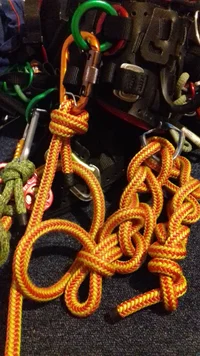

I have gotten in the habit of a double daisy chain for hanging my long lanyard off the saddle. I think I first saw it in a post by AJ a year or two ago. Just as quick to do up as a regular daisy chain but half the length and twice as fast to shake out when I need it.
Nick's method for daisy chaining yet still being able to deploy more when needed:
Nick's Daisy Chained Lanyard

It's still too long and tangly. I suppose it could make a 12-15 footer available pretty nicely, but if it goes much below my knee, I'm not dealing with the snagging and tangling.
I absolutely hate stuff hanging low too, which is why I use this method:20191007_220045.jpg
I believe I first saw @Mark Chisholm do this using the upper D, but it gets to crowded up there with a biner and two strands of 12mm, so I added a gear loop just for the lanyard. You could use multiple loops for a long lanyard.
I just stole the half hitch from Nicks video, that should solve some problems for me.
I absolutely hate stuff hanging low too, which is why I use this method:View attachment 62704
I just run one that's about 7-8 feet long. With the tail clipped on that leaves me two loops hanging close to 6" under my knee. This thread is about moving in oaks, right?
