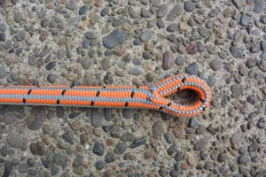

I just got a piece of Marlow Vega yesterday and decided to try to splice it with the Marlowbraid method. It took me two tries but I finally got it. This is not easy stuff to splice, despite what some of the online websites claim. I also took it out and climbed on it with my Roperunner. My initial impression is that this is perfect rope for SRS. It has less stretch and better hand than HTP and is very smooth with the Roperunner. The outer cover is tough and this stuff is really strong (8,272 lbs). I noticed a bit of flattening on rappel, but no worse than HTP. I think I may have found a new favorite for SRS.
Nice smooth taper, Arlo. The top part of the eye, coming out of the throat, looks to be bigger than the bottom half. I zoomed in close and measured the top at 1 3/4" and the bottom was 1 1/2". If you used the directions that have you empty the eye cover, and then refill it, the taper point might be in the middle of the eye, instead of all the way around back to the throat. Comparing the eye to a section of rope not spliced will let you know if one is not right.

I am pretty sure the taper point is inside the throat as I seated it inside the throat before I buried the cover. I used the method that is on the video on the Marlow website where you extract and bury the core and then taper and bury the cover over the top of the core. It sounds to me like you are talking about a slightly different method? Is there a different way to splice Vega?
Yes, Marlow has specific instructions for Vega, very similar to the Marlowbraid. You might to do the comparison test, as the eye should have a consistent diameter.

Ahh crap, I missed that. Do you have the link? It does not come up when I search.
Thanks for posting the link. The Vega splice has the core being tapered by cutting out half of the strands. Different from the Marlowbraid that reduces each strand by half, a little more work, but I like the idea that all the strands are involved, through out the splice.
The illustrations for this splice don't make sense to me, the core bury appears to exit on the top. If the needle is inserted on the top and goes through the eye, it will have to pass through itself, brummel like, at the throat. This would be similar to the NER heavy duty kernmantle splice, but they don't mention anything about this happening. It would seem that the core needs to exit from the bottom and the cover from the top.
And, is it just me or did the yellow and green dots trade places between panels 8 and 9? Or did they - Oh never mind . . . . sign me confused too! Sorta like trying to follow the Samson splicing illustrations when you first start out fooling around with linear fabric strands?
Another confusion is there are no recommendations for bury length based on rope diameter, except for the Vega. Also, Marlowe has put out a few variations of this splice in the past.
When I did it I removed half the strands by removing either 1 or 2 of the 3 strands in each of the 8 core strands. That way all 8 of the tapered strands run completely through the splice. It is a bit more work than just cutting off 4 of the 8 strands, but I like the idea of all 8 strands running completely through the splice. I am not sure if this makes any difference in strength of the splice, but I doubt it. These splices are so different from anything I have done before that I am still very curious about how they effect rope strength. Guess it would be smart to do a few and have them tested.
