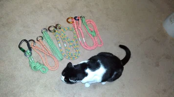

Ok cool.. I'm rather glad to hear that Casanova cuz I'm back at it again.. I got some little 3/8 tenex tech & want to make some stuff out of it. I have 20ft & was wondering if anyone knew how i could stretch it the furthest..
I want to make either a loopie or whoopie with Steel Rings or Pinto Rig.
However at the same time i want to make a Secret weapon with the aluminum rings i have or a Pinto Rig Loop/E2E. I got porked on my last Cordage order & my beeline is on back order so I'm trying to stretch the Tenex-Tec into a few different things here.. i just don't know what will take more rope, a whoopie or a loopie & im getting lost in the measurements of them all.. (actually don't have any for the loopie)..
Here's what i have to work with plus another red & blue ring it's just inside right now.
Sent from my Pixel 2 XL using Tapatalk
Ok.. all done.. i knew a few of you might like the cute coral colored whipping so i threw it on there for ya..[emoji6]
Now.. all i have to do is destroy my project & make a legitimate one with correct buries..lol.
