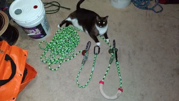

Ahh.. ok.. cool man! I just got done with a 10m Op prusik ring.. I'll post pics in a few..
It went pretty good with the exception of pulling the core out at the wrong mark two times like an idiot. Obviously i fixed it though.. i was half awake i think.
I just got a ton of rigging rope too..
In this order with the 10mm Op i got
30ft 10mm Op
30ft 16mm Trex
30ft 11mmnTrex
15ft 1/2in Optimus (figured I'd try it, never heard of it)
20ft 3/4" Tenex tec
Some #12 marlow whipping
3 or 4 different sizes of heat shrink
Also have 12ft 14mm Sirius
30ft 16mm Sirius
10ft 8mm Veritas
& Then the IceTail i mucked up..
I need to get some rings to go with all this stuff.. but the main purpose behing it all is to make some slings for the Safebloc & Triple Thimble i just got..
I just dont know what to sling them up into yet.. kinda overwhelmed with the options..
