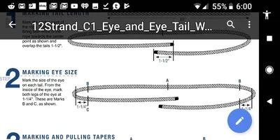

Hey, can we talk about Samson's 12 strand e2e specs got a moment.?
Because of the way it's worded, i get tripped up everytime.. i end up with tails hanging out the x-over that are rather long. I would rather have that wasted Cordage added to the actual length of the whole thing.
Where i get tripped up is early on, step #2. It's like it's missing a reference point, the point at which you want to pull important measurements from.
So if you look at the pic below & you want to end up with a 3/8ths 33in e2e using 80inches of Cordage, how many inches away from center mark A are you placing Mark B? That leg of rope is Dynamic in the sense that once it has a bury in it, it's no longer the length you started with. It shortens up & you end up with longer x-over tails..
Also, when they tell you to measure 1-1/4, where are you supposed to measuring from? Yeah it says "from the inside of the eye, measure 1-1/4in".... But from what point & towards what end? It's showing a mark that isn't referenced as anything..(i think this is the main issue I'm having out of the two)
I know this sounds super stupid, but i think it's the reason I'm ending up with longer x-over tails. It's as if the instructions are missing two important factors to allow them to cover other diameters & i cant find anyone else who provides the literature.

The ends are over lapped 1 1/2", center the over lapped ends at point A. Folding the cord gives the insides of the eyes to measure points B and C. Samson has worked out how much expansion there will be, so it should work out. If this is the splice for Icetail, it might still be incorrect on the buried overlaps, and result in a bump in the middle.
Dang Brock.. i thought i replied to your answer.. I know i typed it out at the least...
Anyhow.. yes.. that's how i do it too.. i just find it a pain matching it all up & if Samson included one more set of set of measurements dedicated to that specific length i think i would have saved allot of trouble the first time around..
