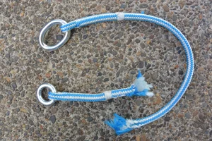

I was curious to see how a spliced 30" Friction Saver in Arbormaster would test, so I sent one to Richard Mumford. In a basket hitch configuration it broke at 11,169 lbs. Check out the big ISC ring. It went from round to oval, but never broke. I removed the core and overlapped the cover tails in this saver by 10".

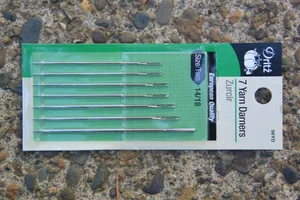

And in regard to needles, I get mine at the local sewing store. I buy Dritz yarn darners in the 7 pack (see below). They have big eyes and are plenty strong for most lockstitching. One of them will last for lots of splices unless you really torque on it. I don't like the big sailmaker's needles because they are too fat and hard to get through a tight splice.

The shaft of those needless look beefed up enough, but what about the eyes, have you snapped any? That's only the problem i keep having.. it's the eyes that are snapping as im pressing them against the table to push through the splices.
What Brock posted is probably the correct way to pass a needle instead of me using the table, pushing, balancing & hoping my fingers aren't in the way..lol.

Oh cool.. was that the same one you showed me a few months ago? It was in response to me asking about using smaller than suggested crossovers?
It was a different one that I sent for testing. I made a bunch of these in different lengths and they were all in use so I made a nice new one for the test.
The eyes of the needles hold up pretty well. I mainly used the bench top method of pushing them through, and have bent or broken a few of them when pushing really hard, but for the most part they work fine.
