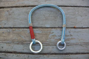

So that 7 & 4 thing... I'm actually in the middle of trying it right now.. not climbing in it or anything like that.. i just had a scrap dead eye i cut off the other day cuz i didn't like how the crossover felt.. wasnt perfect enough i guess..
Either way.. the original dead eye side is buried to spec, i removed all the core & now I'm doing the other end with the 7 & 4.. maybe I'll go a bit deeper with the bury after hearing you mention how that 18in was probably made.
I don't realistically plan on using this one for anything but more than an experiment.. hope no one reading uses that as some legit spec.

So.. i moved the eye up a bit to give me a longer tail to bury & cross.. i only had so much to work with & be able have a usable length tool in the end..
I basically started the eye a couple inches behind where the other x-over ended. The other emd had a traditional 16 strand bury & x-over. It just wasn't very long after that..
So in the end, I'm going to end up with something like a 12-15" x-over.. I forget what i measured.. I'll know in a minute once i smooth it all out to mark the tails.
Test it in the basket hitch configuration - that is how it would be used and would be the most realistic way to do it.
Yeah but won't that give me a false sense of security doubled up like that..? You are right though it would be used like that..
Ok.. so i lied.. somehow i ended up with 10" buried.. swear it said somewhere around 13"before.. probably the rope expanding.. It's bunched in pic so it's only showing 6'' crossover, but I'm pretty sure either way i have less in the crossover than i thought i was getting.. maybe i confused the total buried with the x-over.. i know i did a ton of measuring before burying.
Sent from my Pixel 2 XL using Tapatalk
Ok.. all done.. i knew a few of you might like the cute coral colored whipping so i threw it on there for ya..[emoji6]
Now.. all i have to do is destroy my project & make a legitimate one with correct buries..lol.
