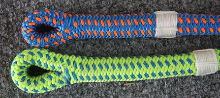

Show off them splices
Sorry the hrc pic didn't come out so good.
Bob, that Tenex sling looks like there's a twist in the eye. I think that can diminish strength if it's built for something critical. Don't want to split hairs on you man, it just looks that way.
When I took the Yale Cordage Splicing Workshop, my rigging instructor bagged me for the same thing. I was struggling over a piece of Double Esterlon, which was the first splice that truly showed the benefit of whipping and lock stitching. It kept backing out while I was making it, so I pulled it apart to see if I had an unbalanced cover/core, and during that process, I lost the natural lay. I had done numerous 24 strand splices before that, and those don't seem to want to back out at all under low loads, whereas the DE seems to want to fall apart without a lock stitch/whip. The eye looked good and all, but the rigger said the twist would make it break lower than it should. I was a bit bummed, but it was a good lesson...so we took another really good eye and put it on the break machine. :(
When you keep things nice and neat on your bench, you can assure that the line tucks in without a twist in the lay for ultimate strength. This is pretty crucial for double braids, too, where you may not be able to see a twist in the core.
Keep at it, bud. Your work shows a good finish.
Thanks for the write up, I'll get right to fixing it. I only noticed it myself in the pic.
Really struggling with a tachyon splice. I'll get sooner or later.
Fixed the tenex splice thanks oceans for the critique. Do it. Do it! I gonna nail that sucker next time around I'm sure. But man it does seem strange to pack all those threads into one jacket. splice.webp
