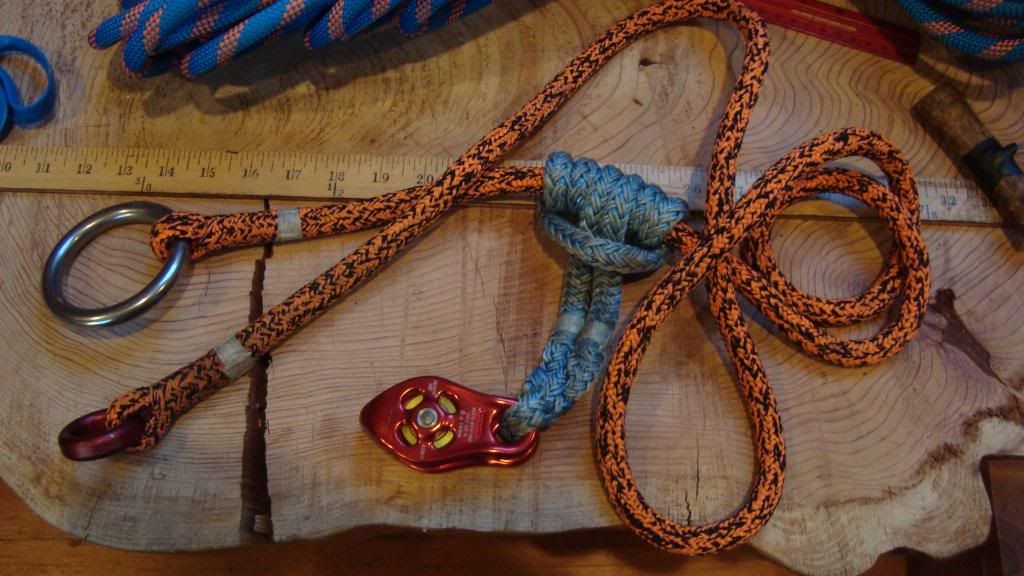

Simple spider leg...
That one is a 10 footer with a 2' (24") eye.
I thought the eye was kinda big, but all the production models seem to have a 2' eye. Makes sense though since it is used for tying either a klemheist or kreutzklem (upside down klemheist) knot
Oh, and it's 3/8" tenex-tec

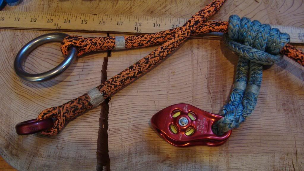

Here's a footlock prussik I whipped with 8mm armorprus, the poly one.
This stuff was a treat to splice, tucks and buries very smooth.
17.5 inch eye, 57 inches overall.

Sweet evo, that imori is nice to splice.
So how did YOU do the pinto tenex splice? Both locked Brummells?
Still like to here the definitive on that thread....
It is possible to do locking brummels on both eyes, You do the first then unweave and reweave the other to make the locking brummel.
There is a thread on here somewhere with greater details.
