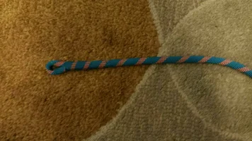

Vortex tight eye...just did my first and it came out sweet. My question is to those of you splicing Vortex, do you lock stitch it, whip it, shrink tube it, or do nothing. Thanks.
Well honestly, as tight as that stuff gets it's probably never coming loose if done correctly...most double braids that is. Hollow braid is totally a different story. But i always feel safer with a back-up. And SOP is to either lock stitch or whip stitch. To me, whip stitching a few inches below the throat is easiest. But you'll still need a sailors palm, or a vise to hold your needle, to help punch it through that 'hard as a rock' splice. Heat shrink will do nothing to assure the splice doesn't back out.
Hope you're gonna show off some pics :)
Thanks Logic, also nice to hear that my splice throat is supposed to be that hard. I wasn't sure but I followed the book to the letter and just figured that was just the way Vortex ends up.
