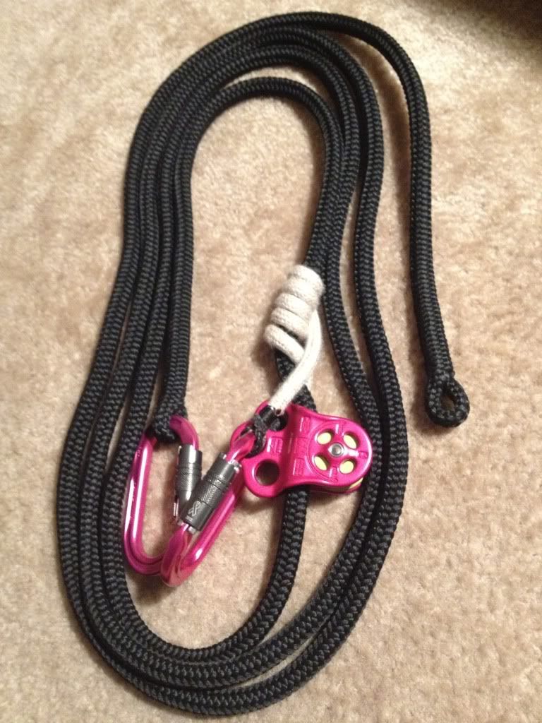

Here is a Yale Poison Ivy tight eye I did for a friend. I really appreciate Nick's tip on stitching the crossover prior to the final bury; it makes a world of difference.
Treezy, You must use Samson instructions..
I use New Englands. The big difference is NERopes has you tuck the core first, then taper the jacket, bury the jacket, taper the core, bury the core, and run the splice home.
What this means is that the cross over isnt really made until the 2nd to last step before running it home. Burying the core doesnt jerk the crossover around a bunch so it doesnt get messed up.
I havent done a PI splice, but I like the looks of yours!
I do pretty much use Samson instructions, although I have gleaned a few tips from other sources like Yale and New England.
I do pull the cover into the core first with a wire fid, however I use a clip to hold the tapered cover end until I get the core buried. Then I grab the crossover unclip the clip and milk the core all the way over the cover. If I am dealing with a difficult rope, then I use a fine thread to stitch up the crossover point and a little further down. That way it is less likely to bunch on the final bury.
