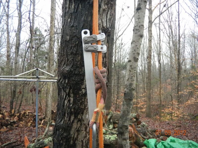

Kevin was ruminating about a stiff tether between the hitch and the RW.
Havent heard much recently on the removable pin for the RW. Looking at some of the other ideas guys have been coming up with, I think there could be a better way. The push pin is quick but looks annoying. I was hoping for more streamlined and tighter fitting in the holes. From what I've seen its going an opposite way to what could progress for the RW. The one way that seems would fit better and keep it streamlined(and safer) is a style like the SPRING LOCK blocks.
A little machining could make this happen. It would keep it snug like the existing pin, captive, sleek and safer.
Why your at it, would making the RW itself smaller more compact affect it's function or just make it look cooler than it already is. Please dont "settle" for the push pin, just doesnt seem right. That mind in your head Kev has got to have room for more ideas
I have found that the Slic pin (available from Treestuff.com is much more low profile and slicker than the push button QRP. It is also stronger and cheaper. downside is it is a little harder to operate with gloved hands. I have made prototype of a swinging side cheeck RW that is attached with a carabiner as etree mentioned but was not happy with it at all because of the bulk and weight that the carabiner adds to the equation. the carabiner negates any effort to make the wrench lower profile.
I do think that the wrench can be a bit smaller and am trying to find the optimal length. I have heard from heavier climbers that the wrench does not give quite enough friction and from lighter climbers that it gives too much. It is hard to find the right balance between angle of bushings and length of wrench. The tighter the angle of bushings, the more friction is acheived with a shorter lever, but then the wrench has the problem of not engaging and sliding down the rope.
How do you guys feel about the adjustibility feature of the wrench? I have debated making the wrench riveted and only for use with standard lines or even making different wrenches for different sized ropes. this would make eliminating the exterior nuts easier. I have found that the difference in settings does not make as big of a difference as I had initially thought. especially when useing the pin.

Kevin i think it would be cool if the wrench was more rounded mid line attachable and with the option of throwing the spacer on to the mid line pin, So you have the option of making the space even bigger or smaller depending on what you are running. My last set up was 10m htp with 8m beeline with a vt. I adjusted the spacer all the way tight to compensate for the smaller diameter pin. I love this set up. My new set up I’m trying to fine tune is escalator line with longer 8m beeline vt with the non mid line attachable wrench opened up all the way. I tried the escalator with the mid line wrench and it would bite down hard and not let me descend, It may have been my hitch though. I went back to the my first wrench, opened it up all the way and adjusted the length of hitch and i think I’m good! I still need to play around with this combo though.
So I would like to see an option to slide the space on or off the mid line pin and make it more rounded so in doesn’t dig in to the trees when redirecting. I'm in the love zone with the wrench!
Hey Gordon, nice work on that stiff bar, wouldnt mind plaing on that, a hole on the top of the bar could work to atach a biner to maybe?
Yes, my thought was it could be an attach point for the hand ascender when going up, or chest attach point as a sort of croll. I think I prefer the textile tether, but it does keep the friction on tap almost immediatly.
Kevin. I replaced my silky zubat blade today and was thinking. Why not make the adjustment pin like those. Then they would be low profile but still adjustable/ removable!
I like it with the Slic pin. I wear gloves all the time and even the winter weight atlas and have not had a problem operating the pin. With a little pressure on the head of the pin the spring is easily disengaged.
Last I heard a couple guys talk about the possibility of loosing the pin when removing the pin. Simple solution to this problem is to not fully remove the pin. If you disengage the pin and release it past the outside plate (only half way) it has a small enough profile to slip even 13mm rope into place. Then you replace the pin the whole way through. Never a risk of dropping!
For those that have had to much or too little friction, try a different sized rope. The static lines you will have more friction and a slower decent the more flexible and smaller the rope the faster the ride will be. It's all customizable for each individual.
