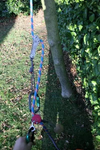

Hi,
Im just getting to grips with the Rope Wrench and have been trying different set-ups, knots and more recently using the Lockjack. I only had a low and slow play with it but decided to take a picture before i put it away. Thought it might be of interest to anyone, someone, no-one.
I'd be really careful with that. Make sure the Jack will engage reliably and consistently. What are your thoughts about tethering while ascending? I think you'll find that when the line asunder tension (wrench disengaged, line in straight path) you'll have to "redirect" the fall side to make the Jack engage. Also, I have for while heading out on limb walks, I can hold the Wrench disengaged with my thumb, and maintain space between the Wrench and hitch with my hand as I break the hitch with my pinky finger. $0.02

It seems to work well because of the friction caused by the wrench it acts in the same way as it would on a drt line, i have been cautious when climbing on it this way with a art back-up line 'just in case', like i said just seeing if it works, next plan is a good limb walk to see if the same forces are applied laterally i.e creating enough bite in the line.
But it seems to work well so far and there are a few in the Uk using it as this setup although my tether length needs to be much shorter i think to make it more compact.
