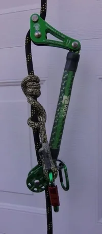

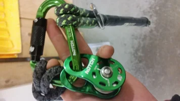

@ Worthaug, @ JeffGu; It looks like you two might be using the same stiff tether. Nice photographs from both of you showing your setups. Thanks to both of you for taking the time and trouble.
So, how are you liking the function of those stiff tethers? Thanks again.
Tim
I have one as well, @TimBr
They're the new stiff tethers from rope logic. They have an awesome little tending loop sewn in just above the eye/eyes that attach to your pulley. They're stiff, alright. I have the one designed for the HC, with the two eyes on bottom.
I noticed, mine at least, does not have that rubber bit on the top eye that worked kind of like a "spring" to set the wrench. But, it engages just fine without. I've had no issue. I absolutely love mine.
I prefer the shortie myself. I am still trying to find toe best pullie for the RW. I have tried the hitch climber, and the rope wrench pullie, the HC has unused holes, the RW pullie has a much larger gap between side plates then I expected.
I prefer RE oval bieners and would like to find a pullie that fits the 2 eyes of the split tail on the out side with the teather eye in between the plates, held fairly tight.
That rubber band is under the heat shrink.
