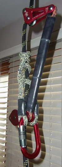

@Levi.CO, it ties like a Blakes but only tucks under one wrap, rather then the 2 over two of a split tail.

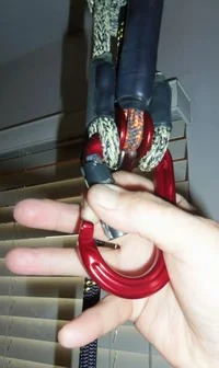

The CT pulley is the easiest one to fit inside an oval carabiner with the hitch cord and tether. Probably the best one for this, but if you use an HMS carabiner, the ISC pulley fits fine. Wish I had better pics on hand of the CT pulley, but these two are all I have at the moment.

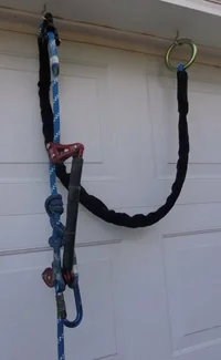

Here it is with a cheapo cmi micro pullie I had. I am still in this constant pursuit of smoothness and symmetry tho. Why can't my SRT system be as clean as a hitch climber system?
Jeff, that is exactly what I am looking for.
I think I still need a shorter teather tho, my wrench doesn't grab when I first sit down after an ascent. The hitch grabs first, and way too tight, sence the wrench haven't absorbed anything yet. Once I climb it isn't an issue.
