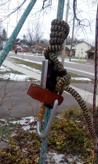

I would like to encourage some of you guys to try a blake's under the wrench.
I was trying to use this 10mm ultra tech for access, but this stiff little epicord just wouldn't grab right for me. So I tried something different. I know, I know...the e2e is not designed for this, but it could be. And it leads to a very short hitch.
I had fun on it today. Only one ascent on it with a little work on the way so far, so I won't call it "tried and true", but it was a smooth worker while I played on it.
I will definitely try it with some other combos and be submitting any that are beautiful for this thread (which should be stickied).20161012_112657.webp
