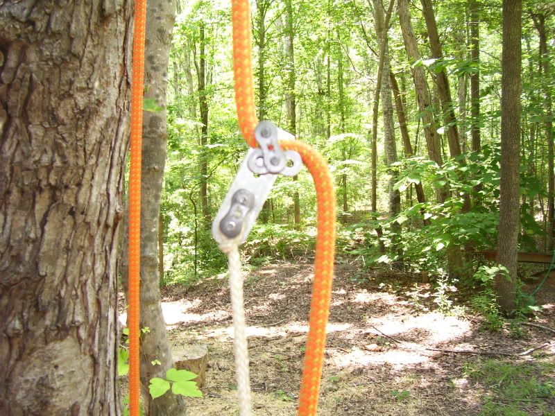

Great device. Here is my homemade RW. It has a frame on only one side. The first pictured RW can be loaded mid line. The second RW pictured (shorter) has to be threaded. They both incorporate a swivel cam for the lower friction point.
