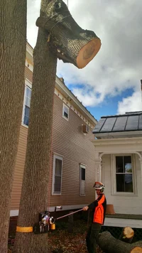

So , go buy yourself a few new ropes. One of each. Just like chainsawsView attachment 34095 . Nice to have a few of different sizes.
Based on your pic, its obvious that your groundie trusts your ropes, Royce :LOL:
