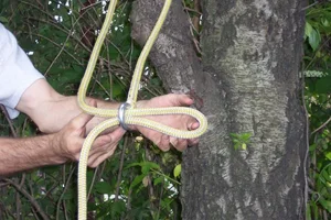

Basically a ring-n-ring FS.

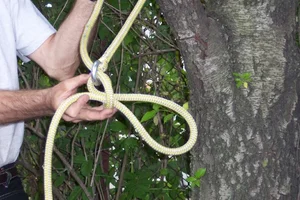

Push a bight of the line through the small ring...

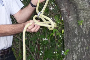

Tighten the slip knot. Clip on a 'biner, put a double sheave micro pulley (the ISC works much better than the CMI)on the legs of the climbing line and clip the micro pulley on the biner. Place the 'biner so that it is away from the ring.

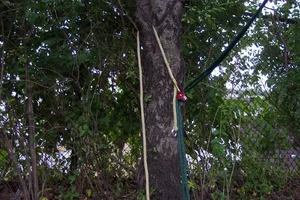

Tie the end of the line (or a second line) to the big ring before leaving. Can be removed from the ground or in the tree.
The weight of the climber keeps the slip knot tight.

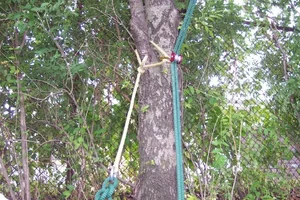

To retrieve pull on the line attached to the big ring. The slip knot comes undone and the FS comes off the branch and down to the climber.
We've tried releasing this with the climber hanging on the line but couldn't do it. The 1/2 inch line barely fits through the small ring and the weight of the climber cinches the whole thing tight.
