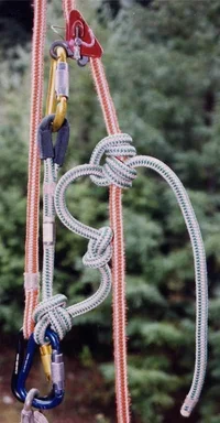

Yo AA(Gary?), you sent PM's about me to others before I even posted in your threads.....so I call troll. Truth be known I think you have a hidden agenda. Maybe it's rants on religion that really set me off. Look, I have jugged miles of fixed lines, the only time I was scared of a rope breaking was jugging to Mammoth terraces on El Cap. Ropes were very old with over hands tied in several places due to rock fall damage. I have never heard of a static line breaking under body weight. In tree work, I think a second line is pointless in SRT mode, you have to trust your gear, if not, retire and buy a new one. Maybe I will pray next time I set sail up a single rope....just in case. Heres my balloon back up....

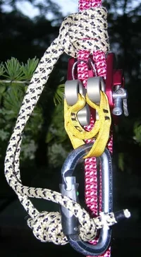

Have some of you exprienced the fiasco at the tree climbing competition and the hassles with the backup tie in for the speed climbs? What a joke this procedure is when you realize that in the aerial rescue and the master's climb it is not made mandatory! Realistic my rear end. About as far from reality as you can get. Safety yes, practical, not so. Yes in the future we may be required to cover our self's when climbing on SRT. You should always in my opinion back up the clip on cams. The cam opening's sure do look like they could get either stuck open or jammed with debris. Even on my friction hitch with the DLT I often use a back up microasender for my own piece of mind to prevent any slippage. (see Attachment)
I've often wondered if this would catch me if I came to the end of my rope and I didn't have a stopper knot? I actually developed this to shorten my split tail when I got up into the tree and to also give me that piece of mind knowing their will be know slippage.
To come down on this system it will require you to release the tension on the microasender cam and slid it down on top of the friction hich. When you let go the microasender stops you cold and the friction hitch is the back-up.
