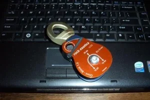

To all, this is my "high tec" version of suspenders and a belt. A 75# zip tie snugged up, fits in just right because of the angles on the rounded portion of the block, it holds its position and it is impossible to open the side plate while it is in that position.
It takes a strong thumb to push it over the top so the push pin can be released.
What do you think?

Makes sense but the swivel would not swivel. Why not just use a nice rescue pulley? Or...a rescue pulley with a screwlink to a swivel? If you feel the need to swivel.
