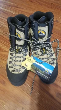

The Makula's came in yesterday, man, stiff, like walking in ski boots, don't know how people use then for hiking or mountaineering, gonna likely put these on and take them off contract spur climb.
those boots are likely designed for crampons, most ice climbers have a separate pair of approach boots for the hike in.
