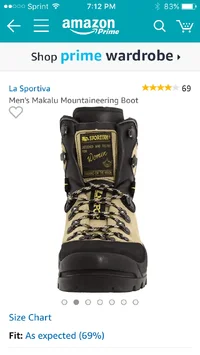

I can say that the La Sportiva Makalu's are the most comfy climbing boots I have ever worn.

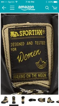

Let's zoom in on that......
Hmmm. Weird.

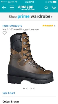

LOL. Just kidding Rico. Those look great. I might get some. I shoot for $300 as a limit. Getting harder to do. I've been in Danner Super Rainforests for about 8 years now but they're about to crack $400. Gonna find a new boot. These Hoffmans look sweet but the price:vomito::

Spur climbing is my thing. It's what I do. Trust me when I tell you, go get a boot thats used by folks who spend their lives in spurs. It will make a massive difference in your comfort level. Don't waste your money fucking around with some Arbpro's or any other arborist boot. You need a boot with a serious shank inserted in the insole. Get some Hoffman Pole Climbers, Power Lines, their modified Meindle Linemen, or some La Sportive Makalu's and be done with it. If they don't make a huge difference in your spur climbing pain I will do a swan dive out of a 200 ft Fir and pay for your new boots ( if I survive the 200 ft fall )!
Hmmm. Weird.
Gosh Bucknut, you had me worried I was wearing woman boots. Lucky for me I bought the mens version!
The Hoffman 10" Pole Climbers are $310. The dual steel shanks make this boot a truly all day spur climbing boot (walking on the ground in these things sucks). Plus their hand made in the USA by a great family run business! Whats not to like?
