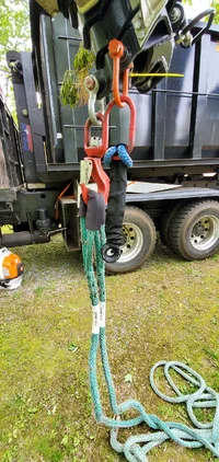

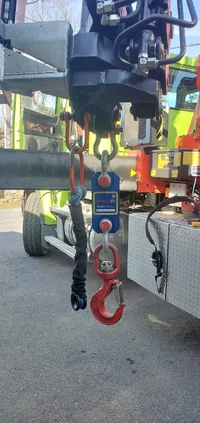

Here is what I use almost every day and at Crane Safety Climber School
Current setup using NJ Crane Experts
Previous tie in
I do miss having the extra metal ring in the system...it helped prevent material contact if boom is vertical.
