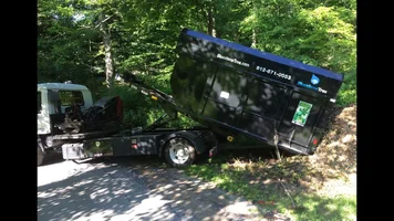

Here is my setup, it sits pretty low now and I have 8' aluminum folding ramps. It really needs 10' ones but I'm happy with the durability of the ramps. The second pic is one of me getting the truck stuck and pushing myself out with the switch n go bed.
