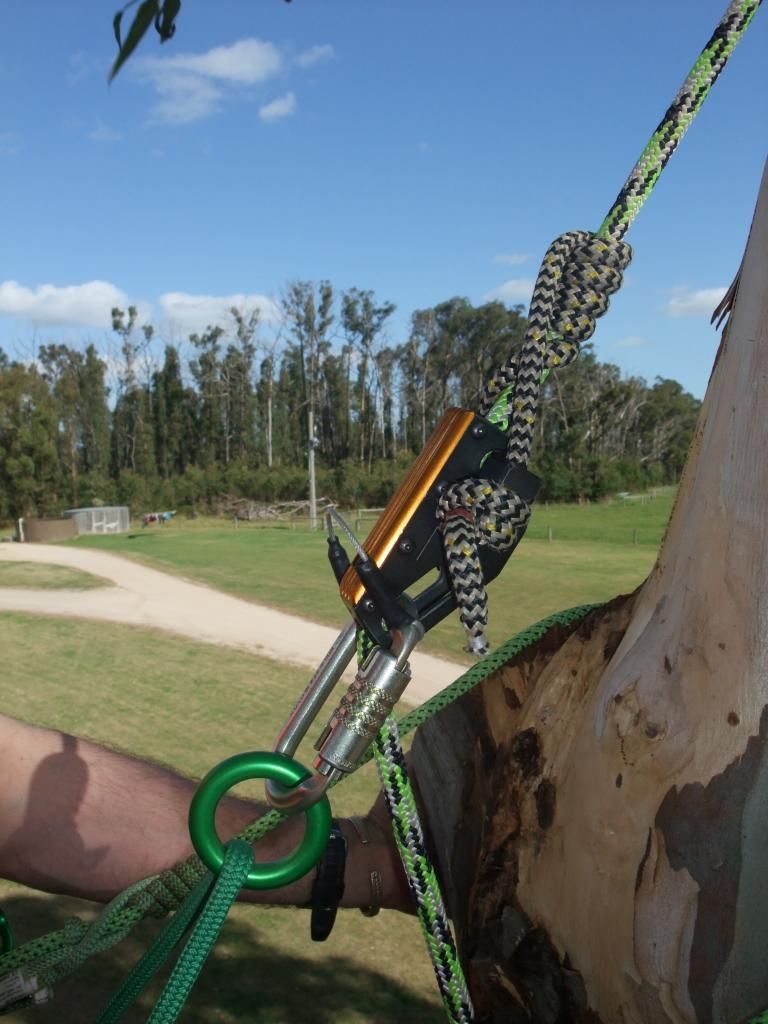

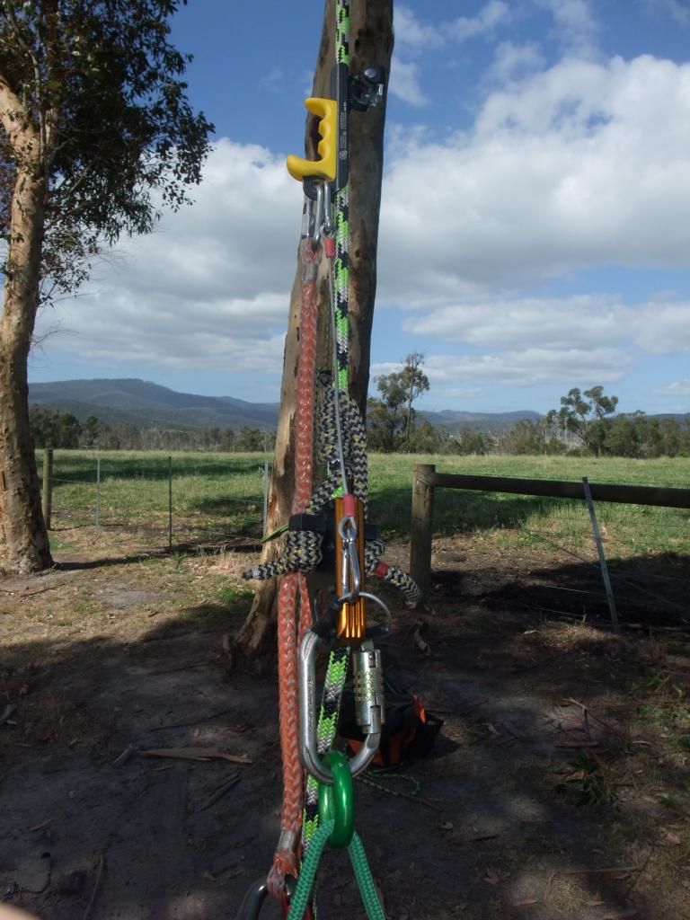

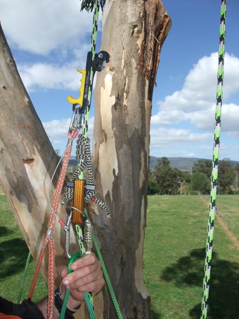

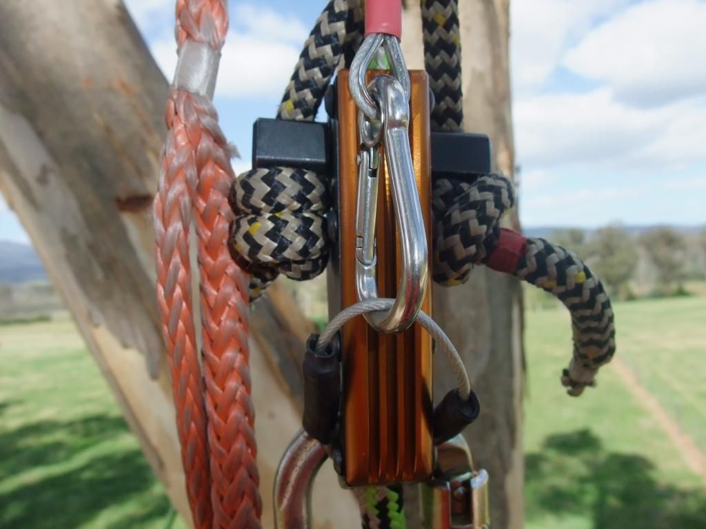

Here's a couple of pics of my ascending setup. I took the rope walker from my RW setup and grafted it over. The shorter tending loop works well.
A helmet cam would be a good thing...
Nice, clean set up, Tony. I use something very similar but with a few changes. I really prefer to not have the cammed ascender tethered to my harness due to its capability of damaging the rope from even a small fall. That and I use a shoulder strap for advancing the HH.
Light weight, simple, safe and efficient...thank you Hitch Hiker.
Dave
Tony, I like your whipping to indicate how to tie your hitch length.

Hi Nick, yes, the Kong ascender has a B/U tether to my bridge, this was so for the RW in the case of sitting back or worse fell back and the hitch wasn't set properly. Not really required with the HH due to the way the hitch is tendered in a set position by the HH. And correct Pantin right foot.
I am a newby to climbing Dave and when I first started was self taught so it was all about B/U. I have read a fair bit on ascenders and rope damage, shearing force and cover damage etc and now understand that a cam ascender is not the ideal thing to use as a back up in a system. As for mentioned, I don't need the back up as such now as I am confident in my tech and the HH. At some stage I'll splice up another foot loop out of Tenix without the B/U.
The neck or shoulder lanyard IMO would be the better choice as it tends the HH square to the body. I've used my CE lanyard over the shoulder in this fashion. I found the tether from the Kong on a long ascent slowly works the HH and hitch around 30 odd degrees, no biggy just requires a little resetting.
Hey Paul, the whipping just lets me know what the min tie is to be with in the 2" max. Last week I ordered a Petzl hand ascender to replace the Kong but It didn't arrive before the weekend. I have a SRT ascender that works well but its a bit clunky and industrial.
