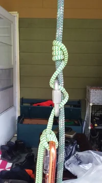

I know I tried a few small modifications, and contemplated switching to the rope wrench before getting the hitchhiker dialed in. All of a sudden it just clicked and is super smooth now. I'm using the original oxane carabiner and no tending attachment. I clip my chest harness into my RE rook on the bridge and it follows me up the rope. When I finish my ascent I do push the HH2 up the rope to eliminate sitback since I don't tend the HH2 directly. Just keep working the hitch cord and try different combinations. I've mentioned it before but I'm using 9.3 Arbpro with 4 wraps on vortex, I am also a bigger guy at 260lbs so you may need to alter the wraps to best fit your needs.
I also have to say thanks to @DSMc for helping me find this combination. I have read thread after thread and consistently saw where he recommended this rope and hitch combo. At times the original 10mm beeline that I was using before would bind so tight I could barely take in slack after a limb walk. The Arbpro is super smooth, it makes the HH2 much more fun to climb with.

You're close, rope! That configuration probably will only work for a short while, until you've cycled it up and down a few times, then the tails will get longer and the wraps will start to bind more, until they almost lock up. You need to keep the ratcheting action trapped by a knot of some kind.
I tried using a split bolt electrical connector on the bottom back braid, but that didn't work either, the cord would slip through with use.
I didn' want to over tighten the bolt on the cord, doesn't seem advisable to squeeze it too hard and distort it.
If you go with a knot, the screw link won't be long enough to let the knot spread out and form a bend in the rope.

Go to post #38. This is how I have been running the HH as of late. Please ignore the stopper knots, as they are for picture purposes only!!!!! Brocky's Bust-A-Knut Hitch has been working extremely well for me on both the HH and the Wrench.
