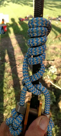

Brocky: I tried this today. It worked amazingly well - even exquisitely. It tended better than anything I've used with the HH – almost like there was a pulley in the system. It advanced very easily & smoothly. On descent, it released with very little pressure and grabbed instantly upon release. It made for easy, predictable slides (swinging descents). It was just a couple of low & slow practice runs and one work climb. I'll have to do some more climbing with it but it deserves its own thread – IMO to not derail Richard's thread. Good work! THANKS! Brocky Hitch 0.webp

Hail to the Brocky HH Hitch! This Hitch took a great tool and made it even better. I had a chance to use it yesterday while setting lines in a few 150 ft + Redwoods, and today in a good size Fir removal. Slack flowed through it like water, it grabbed instantly, and was ultra responsive on descent. Looks like I’m gonna be flying the HH a lot in the near future.
Brocky: I tried this today. I worked amazingly well - even exquisitely. It tended better than anything I've used with the HH. It tended almost like there was a pulley in the system. It advanced very easily & smoothly. On descent, it released with very little pressure and grabbed instantly upon release. It made for easy, predictable slides (swinging descents). It was just a couple of low & slow practice runs and one work climb. I'll have to do some more climbing with it but it deserves its own thread – IMO to not derail Richard's thread. Good work! THANKS! View attachment 54631

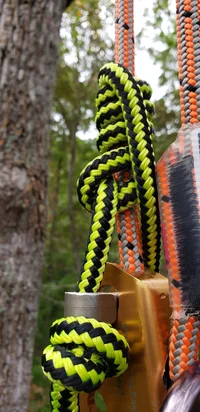

This hitch is really a game changer, and has made the HH a damn near perfect tool for the kind of work I do.
This is how I am running the hitch. I have found that if the crossover of the hitch is faced forward instead of towards the climber it tends even better!
Thanks again Brocky for the amazing hitch!
View attachment 54665View attachment 54666
Better? Impossible!
Excellent discovery! Now you know how I do it, look at what you got and ask what if I do this. Some of the friction is now directly above the dogbone, making for easier tending. Does it still grab each time, as that part has lost some friction?
Those are testing, picture taking stoppers!!
Exactly. Having the hitch directly above the bone make for easier tending, while also allowing for a short hitched with less sit-back, that bites every time.
Yea those are picture stoppers, and not appropriate for climbing, unless your insane!
