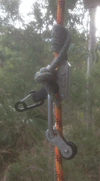

I had fumbles with the fixed side plate pulleys, tried quite a few, found most to be awkwardly short and hard to twist while half on the carabiner getting the rope in and ring on. Tried a lanyard tending pulley with loose side plates, liked the easier installation but still a tad short (rope pinched on bridge ring sometimes due being squeezed in tight by short pulley). Tried an ISC RW pulley was okay but bulky and still a bit fiddly. Bought a Camp Andry pulley for the long side plates and gently straightened the originally curved plates in a vice, rounded off all the shear edges with a chainsaw file.
Two steps and No loose parts. One side stays on the carabiner permanently including while clipping/unclipping the bridge ring, (one step). The extra length and loose side plates makes swinging the free side on/off the rope and the biner real easy.(the other separate step).
Way easier than the ISC pulley to install, about twice as fast which is odd cos the ISC is only 6mm-1/4" shorter from pulley centre to the back of the biner hole but the hole is narrower there so doesn't give as much twist available which makes all the difference. Otherwise the ISC is a good choice as others have already noted earlier, and needs no modification and has much higher load rating..
So far no issues with the rope coming off the side of the pulley when being pulled on angles, wider-flared cheeks at the pulley end would probably increase the odd angle range though.
That is a nice looking pulley. Do you run it the way it is set up in the picture with the HH2's open side facing you?
Yes, only for the fact that the bungee neck- chest tether releases the carabiner in the lower slot way better as it's a direct pull in line with the direction of the lower slot :- lifting the carabiner away from the spine. With the HH the other way round the pull can be 90 degrees across the slot so not much disengagement force and a much harder pull to raise the HH. This may not be such an issue if I go get less stiff climbing line, I don't know yet, still experimenting, just trying to get unnecessary energy out of the system.
