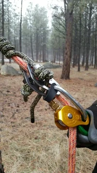

I recently switched to a rope bridge harness and can finally try a tending pulley with the Hitchhiker. If you're running a rope bridge and a Hitchhiker, this set up is worth a try. The ISC fixed plate pulley works great. I'm running the hitch described in the hitchhiker instructions but with 6 wraps and no braids. I'm around 240# with equipment. Thanks for the inspiration Fireman33!
Is that tachyon? How do you like the rit on there? I wondered if the isc pulley would work. I just ordered a petzl fix for my HH2.
