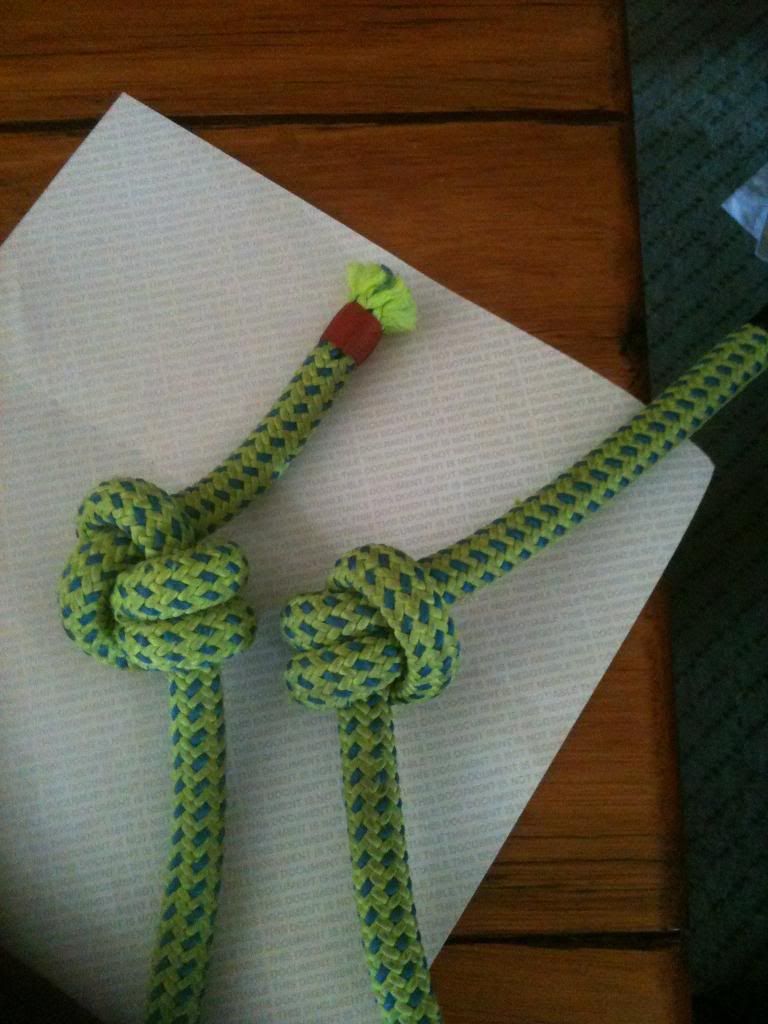

I always thought double overhand was just a different name for a double fishermans. I learnt the double overhand when I was a child tying rope halters and later was taught what I thought was the same knot as the double fishermans. Have I missed something?
Sorry for the off topic question.
Double Overhand
Double Fishermans
Stevidore/Double 8 Left Pauls Stopper Right
Paul's stopper is tied as a double overhand, but like Mahk Adams has said before, it hasn't been dressed and set in the normal manner. Mahk has also said that he has seen it dressed and set like this before, but he doesn't know how secure it is compared to a properly dressed and set double overhand.
I and others have not had any issues with the TDS method of the double overhand stopper knot that Paul has with the HH.
The stopper knot that is on the TreeMOTION saddle bridge is a double overhand knot, TDS in the traditional method. When making the traditional double overhand knot, be sure the turn is seated across the entire knot.
Paul's HH stopper knot is essentially an Anchor Bend tied into itself, except it's reversed. If you loosen it a little and slip the upper turn over the lower turn it's converted into a traditional double overhand.
