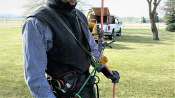

I use the stiff horseshoe tether wesspur used to sell. Clip another carabiner on my bridge ring. Pass the eye of the rope thru the tether and clip into that second carabiner on my bridge ring. Use it ddrt and having it in this configuration keeps the hh upright and in place and from floppin all over.
I have gone the other way and no longer use a tether on the carabiner at all. For DdRT the least complicated way to go is just clipping into a bridge ring. For ascent and everything else SRT, this setup is superb.
