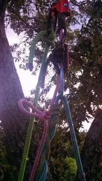

Has anybody tried this? I tried it out yesterday and it worked very well. The object is being able to work both sides of a large canopy. This is a crude set up, using stuff I had on hand at the moment. I would say that you could use a pinto pulley on the HH carabiner to avoid having your drt line rub against the ascent line if it rotated as you worked.
In case it doesn't make sense in the photo, I climed srt on the HH, once in position, I installed a drt system onto the HH carabiner and routed the line to the opposite side of the tree. I worked that side then came down to the line, pulled out the stopper knot and my drt line and pulled the HH down with the additional line and micro pulley...worked the other side of the tree SRT on the HH. I doubt I am the first person to think of this but I haven't seen it.

Interesting concept, Tenn. What about setting multiple routes through the crown by tying in another line for SRT use? You can add in an Alpine Butterfly and Tie in a second line by using a double Sheet Bend in the eye if the Butterfly. You can route the second line by tossing it (with some skill & luck) through the desired path of the other side of the tree and run SRT on both sides.

Oceans - Yeah, It is probably somewhat overdone. I really just wanted to try it after it popped into my head. The system could be streamlined a bit with the use of a smaller line for the HH retrieval...probably several other things for that matter.
Definitely not the only way to do it but It seemed quick enough to set up. I haven't tried the alpine butterfly but it seems like it might be difficult to retrieve two lines with multiple redirects?? Also I didn't have to reset my HH in the tree which was great...
