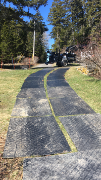

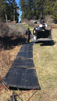

My mats have more than paid for themselves this muddy hell hole of a winter. I’ve posted this before but you all need one for logs.
View attachment 87280View attachment 87281
