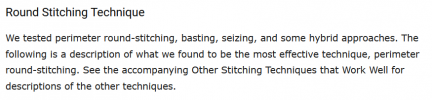

An easier and seemly stronger method of hand sewing is the Round Perimeter method, not as nice looking but stays more flexible, which might help with more strength retention.

Here you go...
Scroll down about one third the page, and look for this:
It goes on for quite a bit after that. Unfortunately there are no pictures or diagrams.
Again unfortunately, they used terminology only known to those who already know how to do the task at hand. The rest of of us are left to guess at what they mean.
OK Brocky. I give up searching. What is a "Round Perimeter" method?

"Again unfortunately, they used terminology only known to those who already know how to do the task at hand. The rest of of us are left to guess at what they mean."
Yup. Kinda anecdotal at best. Writing like this reminds me of reviewing journal articles where the authors come out with something like "It has llong been known that . . " (loosely translated - I couldn't be bothered to look up the original references and cite them for you here . . . ). And so it goes. Even tried Google on some of the terms but only came up with fancy crochet moves . . . but thanks for the link W-man.
