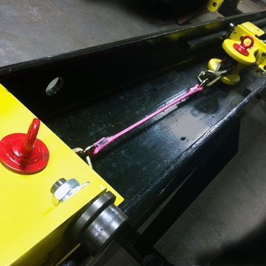

Shit either way i dont have anywhere to break test them actually. Thats why i was thinking to try splicing but shit idk ill have to check around see if i can find somewhere. But thanks for the tread and all of your experience. Good job you know your shit thats for sure.
Which brings me to something I've been wondering for a while - does anyone have a list (or should we start one) of all the break test facilities/ contractors that are available? Maybe sorted by country or something.

Thanks for the shoutout! I do the breaking and I'd be happy to help anyone out. Please feel free to reach out on here or email, brandon@arbsession.com, if you have any questions! I am always willing to chat about results if needed as well.
There's apparently an older Treebuzz 2009 thread on this:
As of Dec 2020, what I found was:
Wisconsin, USA
Greensboro, N Carolina
Vancouver, BC, Canada
If anyone knows of addtional locations please post.
