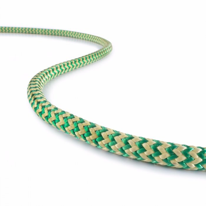

Old bump.... Do you know the make/name of the orange black cordage?
Orange version of this:
Thank you both, that looks like it. Want to try and sew a few thimble loops with it. Will post pics after materials arrive and I get it done.
Just make sure you use triple fishermans knots because dyneema is slippery stuff that can roll outa double
