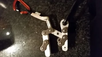

I've found my favourite bdb setup and am posting it for general consideration.

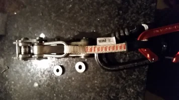

And from another angle:
I attach the caribiner to the hydra pulley on my bridge and the tether to my chest harness.
It advances effortlessly attached to the chest harness.
There is a caution however: if you pull back hard with your back while the tether is attached to your chest harness, the bdb will slip. This phenomenon was mentioned by someone else (sorry can't remember who it was) earlier in the thread. I don't find it alarming in anyway
and to stop the slip just stop pushing back.
something looks different about that CBDB treegongfu. still needs the safety mod (nubs). did you do something to modify the clip-in point?
Treegongfu unless you bounce through the trees like the ninjas in kungfu flix ,which i wouldnt put past you ,I'd fix that bone up a bit. For safety!
That is very interesting Gavin, and is something I have not tried exactly as you are showing it. I have sent Gavin top arms with nubs/handles, in order to facilitate a fix, but evidently the parts are very slow to arrive. If too much load is transferred to the top of the spine, say if the climber was incapacitated, then I think it would release, so please be careful. The spacer aluminum washers are there to stabilize the joint at the spine from side to side movement and it looks like you could add a washer on either side of the shackle to accomplish that.
So if you became incapacitated during ascent, and flopped backwards? Would the bone slip a bit, then set. Or would it slide down the rope unchecked?
It would set. To make it slip you have to rigid.
I reported on this earlier and with my setup I had to have a foot ascender engaged on the rope, lay back with my legs locked straight and my entire body fairly straight to have the BDB not grab. If you were incapacitated, your knees would bend, your body would not remain straight and the BDB would grab exactly as it should. After figuring out the exact set of circumstances required to have this happen, it does not concern me at all.

I did as Gordon suggested and instaled the thinnest washers I cld find on either side of the shackle. They fit but it was too tight so I removed one. Not sure if that slight offset is significant.
The slipping is similar to what gmcttr is describing but more pronounced: I think.
It occurs as Gordon said "when too much load is transferred to the top of the spine"
When i go limp in my harness there is load both on the saddle and on the top of the spine-they share the load and there is no slipping at all.
If I put my feet above my head and hook them over a branch it transfers more load to the top of the spine and it slips.
If I play dead my feet get dragged off the branch as I continue down until they swing free and the balance point is restored. No more slipping.
The length of the chest tether relative to the length of the bridge-pully-carabiner-bdb connection plays a role in this and the shorter the chest tether the sooner pullback will start to transfer load to the top of the spine.
Hope that isn't too long winded and is clear.
Gavin

I was only asking cuz gongfu has changed the attachment point for the chest harness. I was unsure if that would change the mechanics of the apparatus

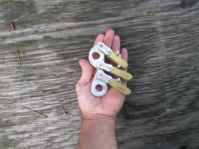

Eric I have made a smaller (wish)Bone using size 60 links. but is not really that much lighter and does not tend slack as nicely.
I still have a big Bulldog Boss(bone) made from size 80 links, but at 26 oz. it is more like a boat anchor.
I don't have a picture of the (wish)bone but here is a picture of a small OAR using size 60 links that will give you an idea of the size.
