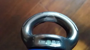

I also noticed wear on the eye that the bridge is passing through as warned about by DSMc.
I've been using the small DMM for a month ...I also noticed wear on the eye that the bridge is passing through...
Damn, wear is visible in just a month? It is rated for use on a bridge so I would hope for at least a reasonable service life. If not I might just go back to a bridge ring as the BDB is still easy to use without a swivel anyway.
Wear is inevitable. If you want to see real wear take a look at how descenders used by big wall climbers wear. I've talked with reps from gear manufacturers who have broken worn gear and found a lot of strength left. If wear is a concern go to steel. Maybe the Rock Exotica one with the clevis pin
I understand that wear is going to happen, I guess I just expected it to take longer than a month. I've never seen a thing on the aluminum rings on my bridge (about a year on them right now), but I guess that is because it doesn't get loaded the same way every time. Never owned a swivel for climbing before. Good idea regarding the shackle swivels.
