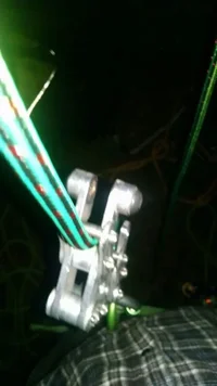

That's a good deal , I jumped on it as noted from pic of my after dinner turkey climb . and that rope literally glowed in the dark , very vibrant , and the bone was making sweet love to it doggy style .. Lol . ..I wasn't sure what a dog and a frog would make but its a good harmony ! I still get blown away by the bdb every time I use it ! I'm trying to save for another before I gotta wait in a line that goes round the earth , but with Xmas coming its better to give than receive dern it.:frenetico:
I also bought some of that .75 cent a foot tachyon. Is that a 3/4 bollard rope for the bone ?
yeah, there is a 3/4" (I think) but the 5/8" bollard & tachyon is the best combo for me yet.
