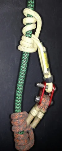

This is my favorite combo to take with me for unexpected things.
I don't see that TreeStuff still has them but the white one is a Sterling sliding prusik, one can be made with a sliding double fisherman's as well, just not as compact. Nice as I can cinch the non pursik end to the connection and or change the size available for pursik vs. the tether or whatever it is used for.
