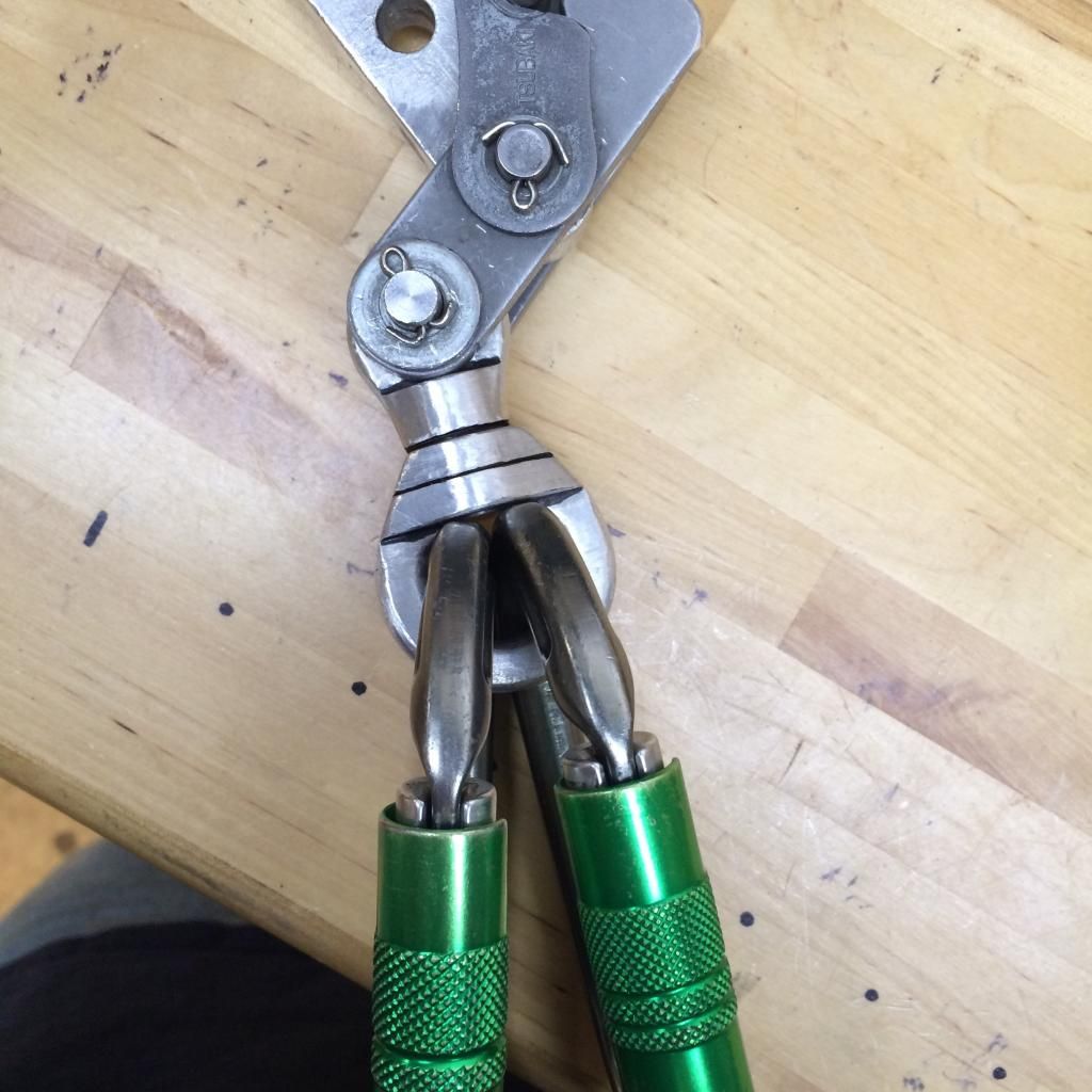

Hi Tyler, I know the nano swivel is nice and everything but it seems like the opening isn't wide enough to guest two biners...I thought having extra room for a second one would have been good to attach my voltige chest harness when I wanted to relax my shoulders...so maybe the one showing isn't the nano...maybe the stainless round small??? Is it easy on the attachment directly on the bone, like nice and even or is it too bulky? mmmmmhh not too sure what swivel is that!!!
It is very easy to attach to the bone and it is vey nice! this is the nano swivel, just without any paint. I was able to snap a photo of it with two ultra O's in it, but rotating them gets very tight.
