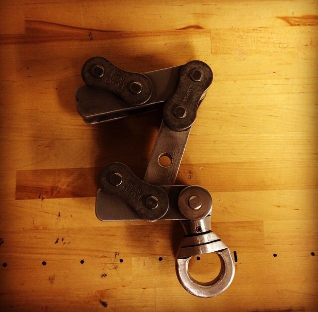

Gave the bone a new look!
Tico, you might try this with the 13mm line if you have not already; install the rope on the bottom arm first like this, swivel the friction link up to the spine and then roll the rope into the notch and then push the friction link down onto the arm, then repeat with the upper arm. Take the rope off in the opposite order. Also you may want to try it with no bollard at all on the 13mm rope.
Yes I had. It's a little less difficult with the lower arm. The upper arm has not 100% link pivoting unless I remove the D ring for tending on top which hindrances the link to properly rotate backwards. I'm planning to add a webbing like somebody had already leaving the sides of the arm clear.
No bollard at all makes the two upper arms to be unstable but it seems OK with the smaller bollard. One question: you think I can also try with the smallest of all bollard brass colored which is inside the 5/8 medium one? Just to see if it works better...?!?!?
And another thing...was the bone you sent to me intended to be used more with fat ropes or it will also support 11.5 or 11.7mm?
Ooops...last one: I noticed there's one link that is shiny and the others are darker...different material???
Anyway, very happy with it...and congratulations Gordon...you're the man!!!

Tico, go back a few pages and there is a discussion about 16 and 12 strand ropes. Seems like some like them, but they are few and far between. I tried some arbormaster......didn't like it. For weight reference, I'm about 215 out of the shower.
Tico, You could try the bronze bollard, just check for wear with each use. It seems that with the Bone 11mm is the lower limit (only with very light weight) depending on the rope manufacture; and 13 mm is the upper limit, depending on the rope manufacture.
