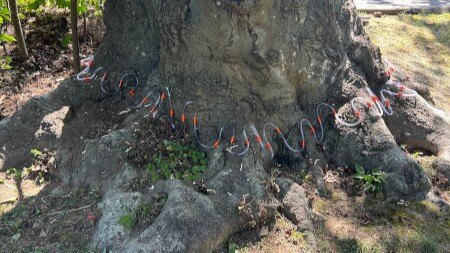

Almost forgot...another email from Rainbow about a treatment protocol webinar.. Copied and pasted from email, I think those links will work.
Upcoming Webinar (2 Time Options):​
Systemic Beech Leaf Disease Management Protocol​
Join Rainbow Ecoscience for an update on our systemic Beech Leaf Disease protocol. During this webinar we will unpack two years of research data and the results with Arbotect (Thiabendazole) injections. Another topic we will be covering is a refresher on macro-infusion best practices and we will close with an open Q&A session. ISA CEUs pending.
Option #1 - Mid-Day:
Jul 23, 2024
12:00 - 12:45 PM EST​
Option #2 - Evening:
Jul 23, 2024
6:30 - 7:15 PM EST​
