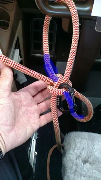

I would ask myself if this would be satisfactory for a stand alone anchor. Does the orientation of the clove hitch effect it's security? How does it fail, rope strength, pull tests etc? What are possible errors in trying it? I look forward adding it to the tool box.
You can orient the clove wrong. When you go to release, it will pull only one loop off the clove, leaving a Half hitch which seems like you could climb on too because for the life of me I can't pull it out. With the clove hitch the right way you end up pulling off both parts of the clove.
I came up with a routine for tying the midline Clove Hitch it so it's tied and oriented properly every time.
Another thing I don't know, (among so many, I know) is what is the ultimate effect, strength, slip and security is when a knot is compromised with a pin or biner passing thru it.
On the paddlesticks I've making it's all good, the radiuses (radii?) around the pin are excellent. The Quickie or carbiner release on the Clove Hitch crossover is harmless, there is practically no rope bend there. The Clove Hitch doesn't seem to care that the release is there, it grabs hard. I did some tests slacking the line and partially releasing the Clove Hitch down the bight, it still grabbed hard when reloaded even though the hitch was opened up quite a bit. Not what I'd want to climb on but it was good to see the behavior. If the bight was made say 2 feet long you've got a lot of forgiveness for partially releasing and reloading the Clove Hitch. But again an SRT climber always has to be monitoring their redirects and overall system. Anytime I make a big move on a redirected rope I load it up and do a quick visual check back through, even if they're natural redirects, I like to see how the tree parts are behaving under load. With remote redirects and anchors I think it's mandatory to do that check, even if you can't see everything you're doing a quick load test to verify everything is solid before continuing. Not to over do it here but anytime a climber slacks their system no matter what they're climbing on they should load it up first before committing to their next move.

Do you think a revolver biner would ease the release, by torquing the clove knot open because of the nose shape at the sheave end, and rolling when pulled to release.
Again as I look at this from a life support perspective I have questions. If not, I find this brilliant and very useful in many situations.
Appears the clove amounts to a two wrap prusik on the bight, which if pulled out releases the redirect.
