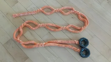

I spliced this version of the ABR ultra sling for attaching a block but I think I'll try turning the block attachment into a double beast boomsling. If I can figure it out it should work great
Here's my version of the double beast ultra sling. Uses two individual carriers. Works well. I posted more about this sling earlier in this thread or perhaps on the other XRR thread. I typically pre set this at a position in the tree where I will start negative rigging. Up to that point it serves as a fair lead into the lowering device.
Great work! I really like the idea of a quick install/Uninstall. Anything to make the job a little easier.
How long is the sling? How big is each hole?
Sling is just over 10'... enough to girth around a 36" stem. I don't have it with me, but the holes are "just" large enough to pass the two Beast rings through. I used a similar sling for about six months last year, but constructed with 5/8" TENEX tec and two large XRRs. It was longer (maybe 12') and I found I rarely used the extra length so made this one with that in mind. While I have no break test data, I consistently dropped 1000+ pound logs into the smaller version with no visible compromising of the cordage. I went to the larger version to achieve the friendlier bend radius. It has proven quite versatile and goes with me to every job in my "basic" rigging kit.
Been using this for a while. Borrowed the sling idea from the ABR Ultra sling from TreeStuff.com (an excellent product), but used two independent lengths of cordage. My original was 5/8" Tenex Tec with two large rings. This one is 3/4" Tenex Tec with two "Beast" rings. At just over 10' overall it will work for stems up to 36" in diameter.
